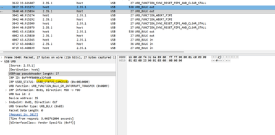

In the attached custom_data_tx.log, transfers work correctly up to a certain point. Starting from the 10th packet, the host-side Python utility reports a USB transfer timeout on the OUT endpoint.
Changing the host-side timeout value does not help. The same packet fails consistently every time.
I also tried enabling/disabling ZLP handling, but the behavior remains the same.

In wireshark it shows as USBD_STATUS_CANCELLED.
