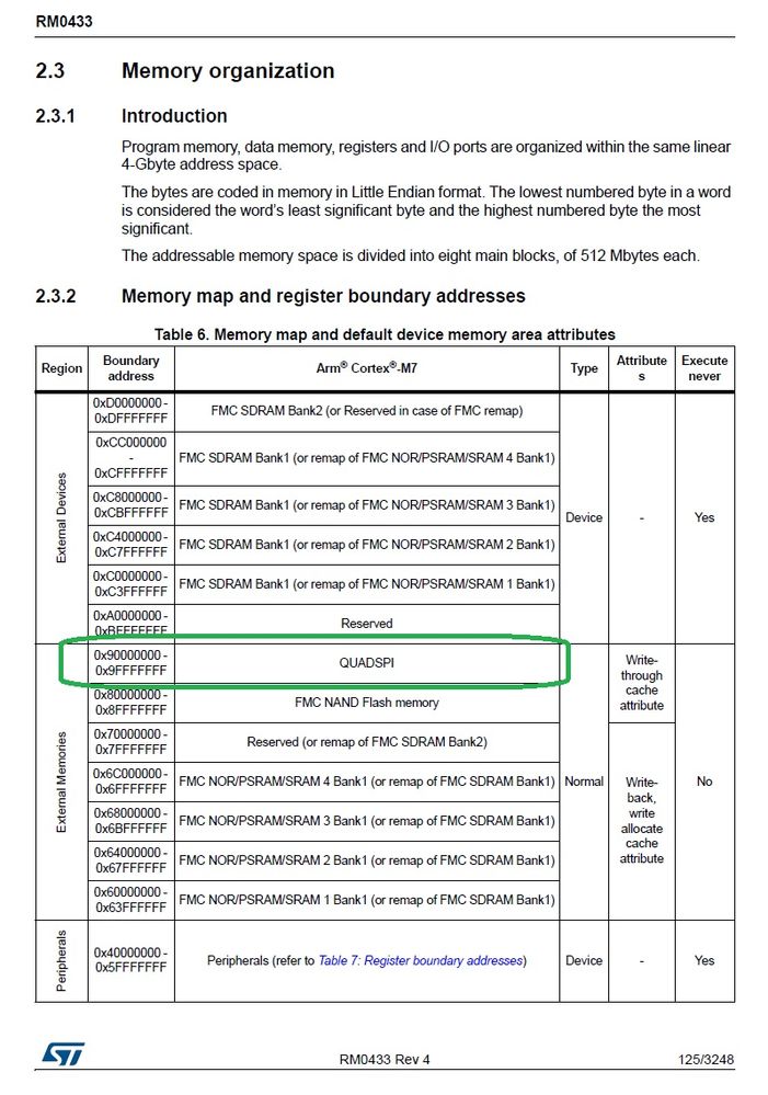

STM32H7 QSPI base address
‎2018-06-28 1:54 PM
When memory mapped what is the base address for external QSPI FLASH?
I can't find this specified in the data sheet or manual.
For the STM32F7 the QSPI base is 0x9000,0000, data sheet table 13.
Where is this information for the 'H7'?
Thanks.
Solved! Go to Solution.
‎2018-06-28 2:06 PM
Reference Manual...
‎2018-06-28 2:06 PM
Reference Manual...
‎2018-06-29 6:26 AM
Thanks Clive. I didn't realize there was a new revision reference manual, and this table wasn't in the previous rev.
