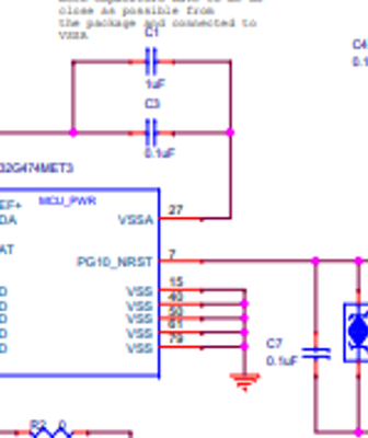

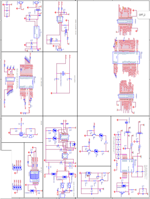

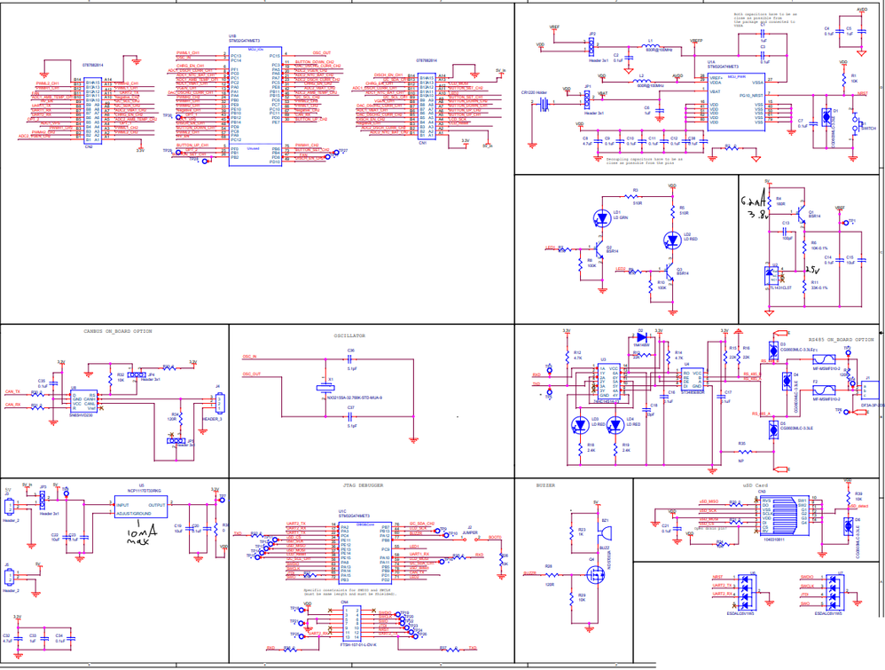

i have MCU circuit with stm32g474met3 as the processor, designed such that it controls the main board charging circuit and it keeps burning randomly at random times could be 5 hours or 20 minuts or even few days I cant figure out why, it burns whether its connected to the main board or not. I tested pin configuration (i.e. inputs and outputs ) and they are all defined correctly. I cant find any issue. and the scheme looks fine. i also removed the 2 0ohms resistors on UART2, and permanently shorted the boot instead of the jumper,
i don't have access to the code of the MCU but how can I electrically find the issue?

VSSA should be shorted to VSS. It appears to be floating in your schematic.

I noticed it as well and connect it but it still burns. And by burn i dont see any physical damage however one or more of the pins i dont know which starts to sink current after fault happens. Under normal operation the mcu board consumes around 50-70mA and after the fault it consume over 170mA even after erasing and burning the chip again or just complete erase
It may not be the only issue, but it's certainly one issue.
The schematic is quite blurry so it's hard to read. But I didn't find anything else. Certainly sounds like a protection diode got blown due to an overvoltage condition. Especially since it was working, then something happened to increase current consumption, yet is still functional. Note that VSS/VSSA should be hard shorted. Some "0 Ohm" resistors are a non-negligible resistance. Doubt that would cause this issue but maybe.
Did you do this after replacing the chip? Because connecting VSS/VSSA if the chip is already dead won't fix the diode that got damaged.
