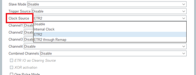

We are trying to use TIM3. We also want to use an external CLK as the clock source for TIM3, but we don't know how to set it.
.ioc file - Where should I change the TIM3 clock source settings?

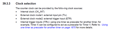

‎2025-01-06 2:57 AM - edited ‎2025-01-06 2:57 AM
From the reference manual RM0433: / section 39.3.3 Clock selection:
You can select an external clock source for TIM3:
In CubeMx:

In CubeMx:
