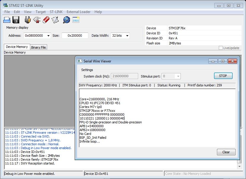

 I am using Atollic studio and the STM32F769 Discovery board.
I removed resistor R93 and fitted a 0R link to R92 so that the SWO line is connected to the ST-Link on the discovery board.
I have followed this tutorial to enable SWV and make use of ITM_SendChar:
http://blog.atollic.com/cortex-m-debugging-printf-redirection-to-a-debugger-console-using-swv/itm-part-1
I have enabled SWV and set the core clock frequency: currently 200MHz. (I verified this by calling SystemCoreClockUpdate() and checking the value of SystemCoreClock 200000000)
I have set the SWO clock to 2000kHz.
Unfortunately i do no receive any characters in the SWV console window within Atollic.
If i breakpoint the ITM_SendChar function i can see that its getting to the line 'ITM->PORT[0U].u8 = (uint8_t)ch;' without issue.
I also just tried the 'STM32 ST-Link Utility' with SWO viewer and can see a few characters when I press start but do not see a continuous stream of characters as i expect.
Anyone have a suggestion?

Ok, so not exactly an oranges-to-oranges comparison, I did bring up one of the Nucleo-F767ZI boards where I output to the USART and SWV, no mag-ic incantations involved.

Chris Lynch
Posted on March 05, 2018 at 19:31
          The firmware version I had on the ST-LInk was V2.J30.M19 but it seems to have issues with SWO.
          I just reverted back to V2.J29.M18 and SWO is now working fine

@Chris Lynch, do the characters you see resemble what you print?
-- pa
Posted on March 06, 2018 at 09:31
Pavel,
           Thanks for asking.
            Yes they did, but i only received about 4 characters when i should have received a character every 100ms.
           See my answer above regarding the ST-Link firmware as the actual problem.
