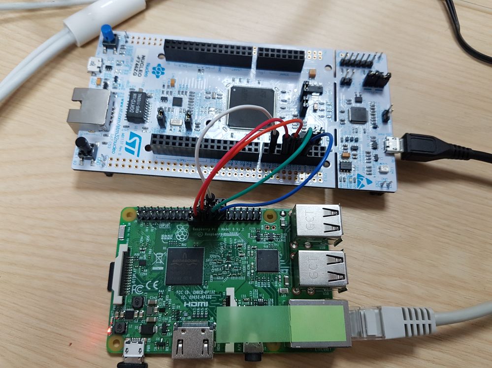

you wrote  'I'm trying to receive data'   As slave or as Master?
Write more detail about  your hardware configuration..
Matt Jackson
Posted on July 19, 2017 at 16:13
Hey Vangelis,
Thanks for the reply!
The STM32F7 is configured as a full duplex slave.  It is receiving data from a Raspberry Pi 3 configured as master.  I've used this Pi to send SPI data successfully to various other dev boards.
Here's a pic to give you an idea.   The wires are nice and short, and as I stated above, I've checked that the Nucleo is receiving he SPI data as intended.
Here are the connections as it's hard to see from the photo:
NSS / CS = CN7 pin 17 (PA4)
SCK = CN7 pin 10 (PA5)
MISO =  CN7 pin 12 (PA6)
MOSI = CN7 pin 14 (PA7)

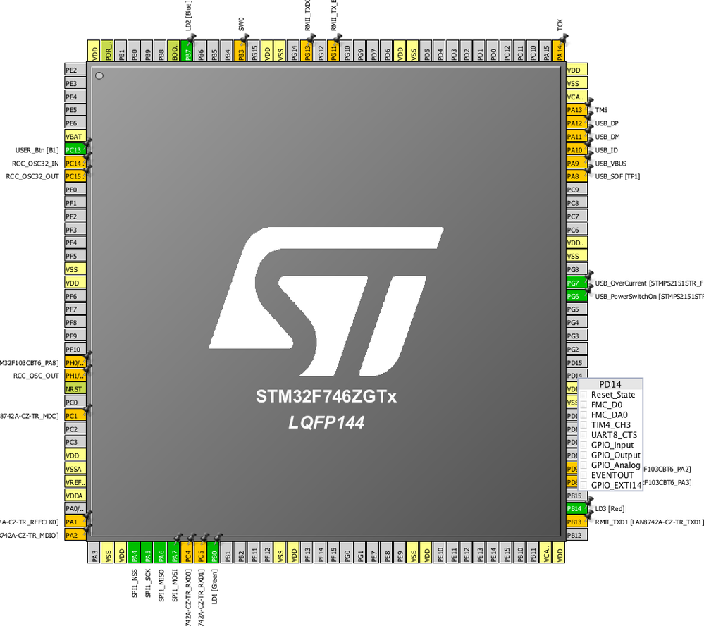

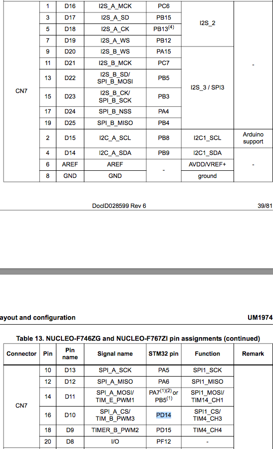

Interestingly, there appears to be some sort of inconsistency  between the Nucleo Manual and the CubeMX configurator.
This pin table says that I should use CN7 Pin16 (PD14) as SPI slave select:
However in the configurator, I'm unable to select that option for pin PD14:
Hope that helps you help me!
