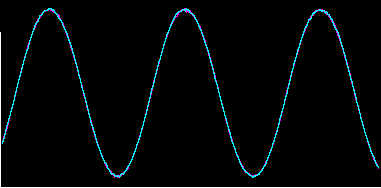

Interesting is that there is really no noise (even without averaging) on the horizontal parts of the curve in the raw data from the ADC. Normally I would expect some LSB changing.
The sinus is perfect at the header on the board. I cannot measure directly at the pin of the µC since it is BGA package. The schematic says that there is no series resistance in between. And again, it's really low frequency: 3.6Hz (not kHz, not MHz), so series inductance of the tracks should not be an issue.
The X-Axis of the diagram shows the DAC value 0-4095 = 0-3.3V, so it's the whole sinus amplitude we see there and not some LSB noise.

your test approach does not help, I need ''high'' (min 10kHz) update rate. Reading without DMA and slow update rate does not show the effect, because the reading is slower than the effect I'm describing. I can also use only every 100th value and output it with 100 times slower sine and I get a ''clean'' reading, see image.
