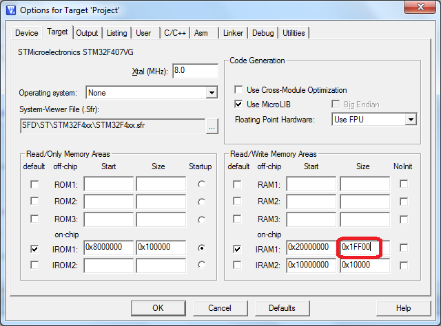

    Could you show me (in C) how can I access from those two applications to specific SRAM area like 0x2001FF00 - 0x2001FFFF? I want place my buffesr there. Can I just use pointers to begin of that memory? How do I prevent compiler to use this space for local  variables so other data won't override those buffers?
    Tesla DeLorean
    Guru
    July 14, 2013
    Posted on July 14, 2013 at 19:37
    You'd want to shrink the IRAM memory allocation in the target dialog, or scatter file, so that it DOES NOT include the space you want to carve out for the parameters. This doesn't stop the memory from being useable indirectly, but does stop the linker from placing data there, and cause it to warn if the RAM requirements exceed the available space.

    I'd put it at the end because it's significantly less likely to be damaged inadvertently, by things like the debugger's flashing algorithm code/applet, or the user application where someone forgot to shrink the IRAM.
    Sorry, pulled the template from some other example

    Posted on July 14, 2013 at 23:18

    I think I should divide IRAM space into two different spaces what I did like you showed in previous image (ex. 0x 1 8000 for 1st and 0x 0 8000 for 2nd minus shared buffer space so 0x 0 7F00) so both stacks won't interfere. But it didn't help.
