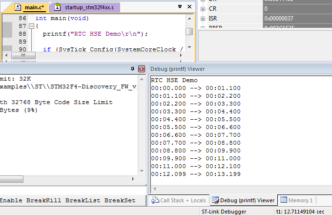

Posted on April 01, 2014 at 04:31
This works for me in Keil,
// STM32F4-Discovery RTC HSE Demo (Keil) - sourcer32@gmail.com
#include ''stm32f4_discovery.h''
#include <
stdio.h
void RTC_Configuration(void)
RTC_InitTypeDef RTC_InitStructure;
RTC_TimeTypeDef RTC_TimeStructure;
RTC_DateTypeDef RTC_DateStructure;
/* Enable the PWR clock */
RCC_APB1PeriphClockCmd(RCC_APB1Periph_PWR, ENABLE);
/* Allow access to RTC */
PWR_BackupAccessCmd(ENABLE);
// Reset the backup domain, clear RTC
RCC_BackupResetCmd(ENABLE);
RCC_BackupResetCmd(DISABLE);
if (RCC_GetFlagStatus(RCC_FLAG_HSERDY) == RESET) /* HSE Already running? */
/* Enable the LSI OSC */
RCC_HSEConfig(RCC_HSE_ON);
/* Wait till LSI is ready */
while(RCC_GetFlagStatus(RCC_FLAG_HSERDY) == RESET);
/* Select the RTC Clock Source */
RCC_RTCCLKConfig(RCC_RTCCLKSource_HSE_Div8);
/* Enable the RTC Clock */
RCC_RTCCLKCmd(ENABLE);
/* Wait for RTC APB registers synchronisation */
RTC_WaitForSynchro();
/* Calendar Configuration with HSE/8 supposed at 1 MHz */
RTC_InitStructure.RTC_AsynchPrediv = 125 - 1;
RTC_InitStructure.RTC_SynchPrediv = 8000 - 1; /* (1MHz / 125) - 1 = 7999*/
RTC_InitStructure.RTC_HourFormat = RTC_HourFormat_24;
RTC_Init(&RTC_InitStructure);
/* Set the date: Tuesday April 1st 2014 */
RTC_DateStructure.RTC_Year = 0x14;
RTC_DateStructure.RTC_Month = RTC_Month_April;
RTC_DateStructure.RTC_Date = 0x01;
RTC_DateStructure.RTC_WeekDay = RTC_Weekday_Tuesday;
RTC_SetDate(RTC_Format_BCD, &RTC_DateStructure);
RTC_TimeStructure.RTC_H12 = RTC_H12_AM;
RTC_TimeStructure.RTC_Hours = 1;
RTC_TimeStructure.RTC_Minutes = 0;
RTC_TimeStructure.RTC_Seconds = 0;
RTC_SetTime(RTC_Format_BCD, &RTC_TimeStructure);

int main(void)
printf(''RTC HSE Demo
if (SysTick_Config(SystemCoreClock / 1000))
printf(''SysTick setup failure
/* Capture error */
while (1);
RTC_Configuration();
#define DELAY 1100
while(1) // Do not exit
RTC_TimeTypeDef RTC_TimeStructureA, RTC_TimeStructureB;
uint32_t subsecondA, subsecondB;
uint32_t MilliSeconds;
do
subsecondA
RTC_GetSubSecond
(); // 0..7999
RTC_GetTime(RTC_Format_BIN, &RTC_TimeStructureA);
subsecondB
RTC_GetSubSecond
RTC_GetTime(RTC_Format_BIN, &RTC_TimeStructureB);
while((RTC_TimeStructureA.RTC_Seconds == RTC_TimeStructureB.RTC_Seconds) && (subsecondA == subsecondB));
MilliSeconds = ((7999 - subsecondB) / (8000 / 1000));
printf(''%02d:%02d.%03d'',
RTC_TimeStructureB.RTC_Minutes,
RTC_TimeStructureB.RTC_Seconds,
MilliSeconds);
// Predict Next expected MM:SS.sss
MilliSeconds += DELAY;
while(MilliSeconds >= 1000)
MilliSeconds -= 1000;
RTC_TimeStructureB.RTC_Seconds++;
if (RTC_TimeStructureB.RTC_Seconds >= 60)
RTC_TimeStructureB.RTC_Seconds -= 60;
RTC_TimeStructureB.RTC_Minutes++;
if (RTC_TimeStructureB.RTC_Minutes >= 60)
RTC_TimeStructureB.RTC_Minutes -= 60;
printf('' --> '');
MilliSeconds);
printf(''
DelayMs(DELAY);
