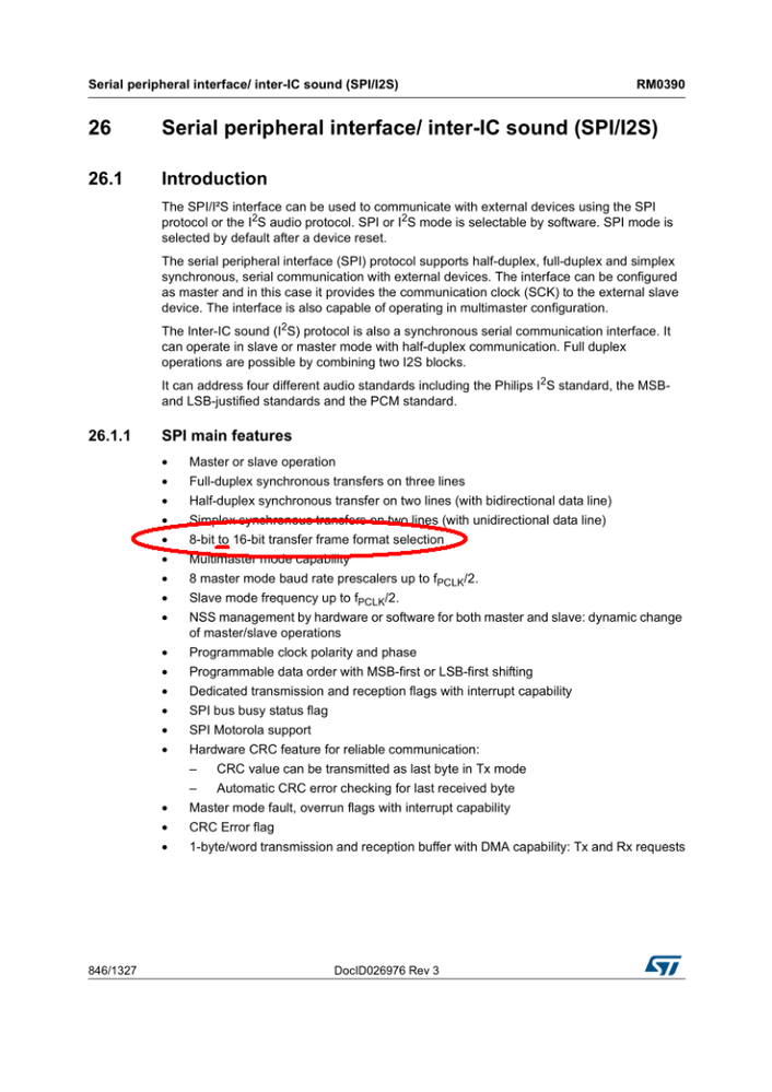

STM32F446 SPI transfer bit width
waclawek.jan
Posted on September 12, 2017 at 19:57
IMO, *to* is inappropriate here - as far as I can see, transfer width in 'F446's SPI can be only 8-bit *or* 16-bit.
Imen.D
Posted on September 13, 2017 at 17:54
Hi
Waclawek.Jan
Yes, I confirm this typo. It should be '8-bit or 16-bit'
I will report this internally to correct it in the next release of reference manual.
Thanks
Imen
