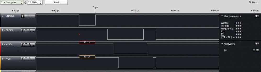

Hi, I just received my STM32F429 discovery board and I tried to implement basic SPI but I'm stumped as to why the logic analyzer output was different. Can anybody point out were I was wrong. Here is the code.

And here is the output of the logic analyzer.
- Labels:
SPI
STM32F4 Series
‎2014-01-12 4:24 AM
I might start by initializing PE3 properly. Tip: Don't enable line numbers unless you specifically use them to refer to something.

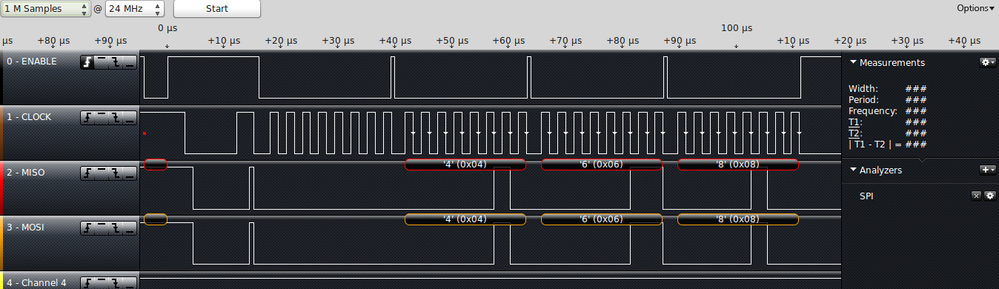

‎2014-01-12 8:20 AM
Thank you very much clive1! So now I properly configured the select pin. But I now got the following result from the logic analyzer...it seems the values that are sent are being doubled. What have I done wrong now?
‎2014-01-12 9:23 AM
Perhaps because the analyzer chooses to use the falling edge of the clock, and not the rising edge?
‎2014-01-12 3:02 PM
I think the logic analyzer trigger as first clock pulse the 'glitch' generated between GPIO_Init() and GPIOA_Config() so the data are shifted left by 1 bit.
Try to set all used GPIO pins to 1 before to call GPIO_Init() either in csInit() and spi1Init() using GPIO_Setbits() or GPIO_Write() so when you initialize the port in output mode, the respective bits in ODR are already set.- Mark as New
