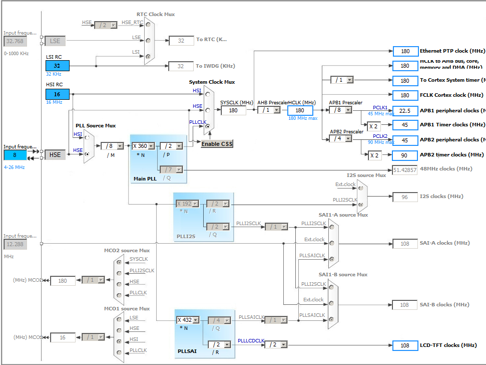

I'm currently developing an app based on STM32F429I-DISC1 board. It works great when the board is connected to STLINK through miniUSB cable, program runs and data are displayed on LCD display. One of the requirements is to make the board work from external power source. I'm using 5V pins to supply power. In this case the program does not start , the screen looks plain white. LD1 COM diode slowly flashes red (It constantly glows red when connected to computer). But when I plug in STLink the program starts. It also keeps running after I remove STLink cable.
Given this, I suppose that the problem is related to Clock setting.

I have such clock settings (8Mhz at input runs to HSE, PLLCLK is used for SysClock):

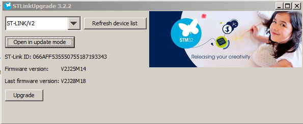

Powered the DISCO/NUCLEO with USB Chargers/Batteries here. There was a quirky build of ST-LINK firmware that would hold target in reset, but current firmware doesn't do that.

Posted on August 19, 2017 at 08:48
I have checked forum somewhat more deep, and found that the common advice here is to use this software. (Not sure what it does...)

Posted on August 19, 2017 at 15:24
Yes, the V2J25 definitely falls into the window of one that misbehaves, the DISC1 was shipped in the thousands of units to Mouser and DigiKey, etc . Stocks might be quite old, and so generally whenever I get DISCO and NUCLEO boards which are not new releases I pull them to current firmware to avoid fighting old demons
The ST-LINK Utilities also ship with an update and drivers, but the stand-alone works well too, some times the releases on the website are not always in sync.

Posted on October 12, 2017 at 23:51
I was having the same issue and the firmware upgrade fixed the problem with the board.
