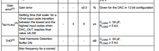

I can not find anything about the settling sime. Only that it depends on the power supply voltage and the analog output load. For now the DAC can follow the speed
From DM00071990.pdf, STM32F427xx/STM32F429xx Datasheet.
EDIT: freakin' forum cannot display images ...
Look at given document, page 161.

so the settling time is max 6mircoseconds. Which meens that 1/819200=1.22microseconds is indeed too fast. So the interupt frequency needs to be at least 5 times slower-> 1.22*5 = 6.1microseconds.
Am I correct?

6 microseconds is the maximum, for full swing and max. capacitive load.
You DAC feeding frequency will depend on the accuracy of the output curve you need (which I don't know).It is not necessarily an interrupt frequency, you can prepare a value table and feed it per DMA into the DAC.
But interrupts at 800kHz is absurdly high, you waste most of CPU performance for interrupt entry + exit.
