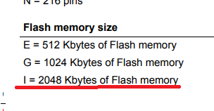

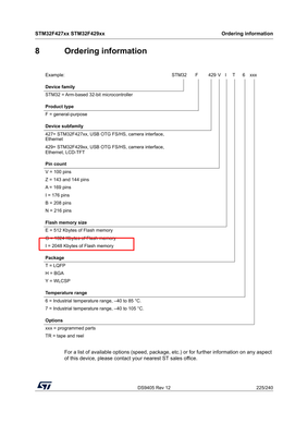

From STM32F427 datasheet : Flash and RAM:
From 8 Ordering information section:
I means 2MB of Flash:
Hope that answers your question.
