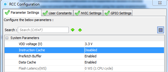

in your first project we use a STM32F415ZGT without any problems. Then we switch to the smaller version STM32F415RGT in a new design. With the same source code we got some times a hard fault when die MCU is booting up.
After two or three days of software and hardware bug finding and trying different versions of CubeMX and F4 firmware we find a solution to disable the Instruction Cache in CubeMX:
After that your simple LED blink code runs fine without any hard fault.

Posted on January 15, 2018 at 08:18
Thank you for your suggestions. I will change the hardware and post the results this or next week.
Tobias Wedell
Posted on January 17, 2018 at 13:56
the problemwere theferrite beads in the VSS and VSSA lines. Bridged them and all is working fine. Many thanks to
Waclawek.Jan
for the hint.
I leave the VCAP capacitor as it is at 2.2µF.
