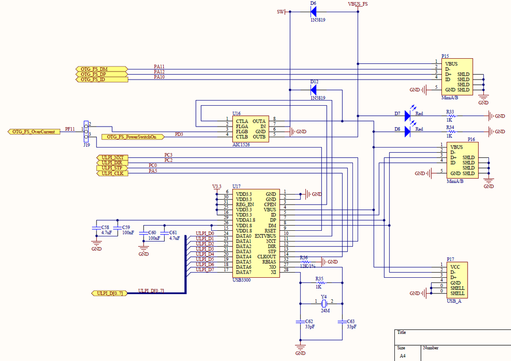

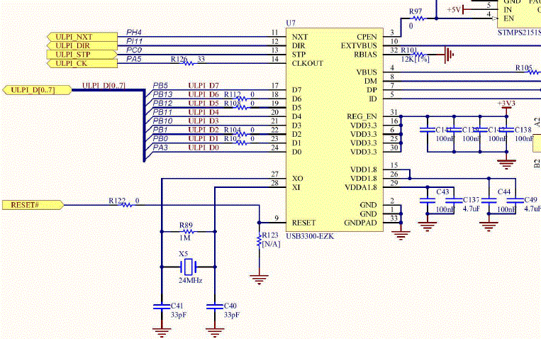

i designed schematic for stm32f407 and usb 3317 but i dont know how to connect their port together...please help me...Thanks- Mark as New
‎2013-08-21 1:58 AM
Have you looked at the STM3240G-EVAL schematics (USB_OTG_HS.SchDoc)? It's a different chip but the signals look similar.

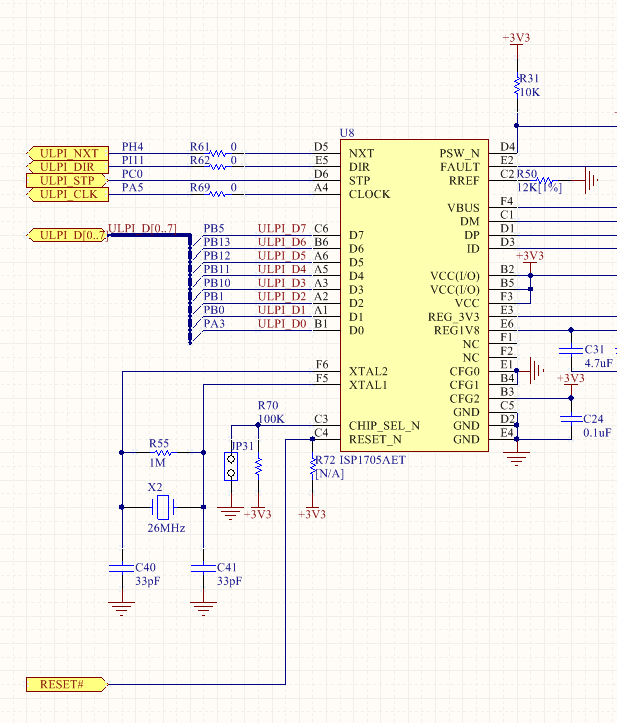

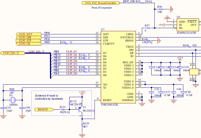

Download the User Manual UM1461: STM3240G-EVAL for the STM3240G-EVAL Evaluation board for STM32 F4 series - with STM32F407IG MCU evaluation board from ST's web site. The schematics are on the later pages.
‎2013-08-22 8:40 AM
‎2013-08-22 9:07 AM
I'm not authorized to do that, what I posted should adequately show the STM32 side connectivity.
I've seen others with pretty much direct connections on the USB, but that doesn't strike me as a very industrial solution. I would probably suggest you look at other USB3300 reference designs.Up vote any posts that you find helpful, it shows what's working..
‎2014-07-26 9:55 AM
Updating the USB3300 section from the current
http://www.st.com/st-web-ui/static/active/en/resource/technical/document/user_manual/DM00093451.pdf
board schematicUp vote any posts that you find helpful, it shows what's working..
