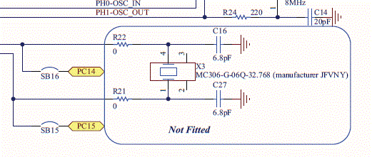

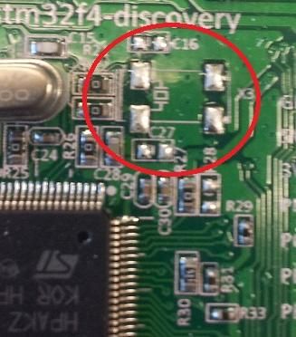

You'll need to modify the STM32F4-Discovery board, it doesn't come with an LSE crystal, at least mine didn't.
Without parts at X3, C16, C27, and removing SB15 and SB16, the LSE is not going to tick or come ready.

The value of the x3 is OSC 32 KHz clock supply?
Posted on September 07, 2012 at 19:32
Yes, it is the Low Speed Oscillator, nominally 768 KHz 6pF
MC306-G-06Q-768
http://search.alkon.net/cgi-bin/pdf.pl?pdfname=07pdf
http://www.st.com/internet/com/TECHNICAL_RESOURCES/TECHNICAL_LITERATURE/APPLICATION_NOTE/CD002216pdf
