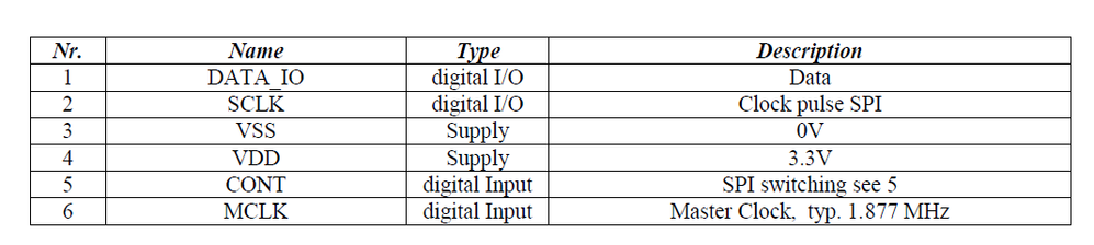

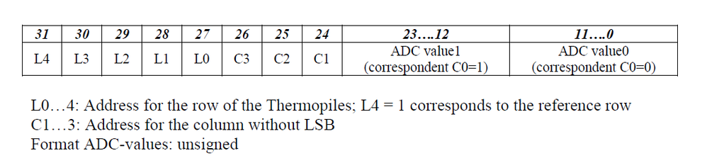

I am trying to interface to the Heimann 16x16 sensor but having issue with the timings and synchronization. There is only one bi-directional data line as shown in the pinouts below.The device acts as a master spi device when the CONT line is 1 and the data is transmitted continuously. When the CONT line is 0, the device becomes a slave device and release the control of the clock and data line. The code use for setting the the STM32 device to a slave device is shown below.

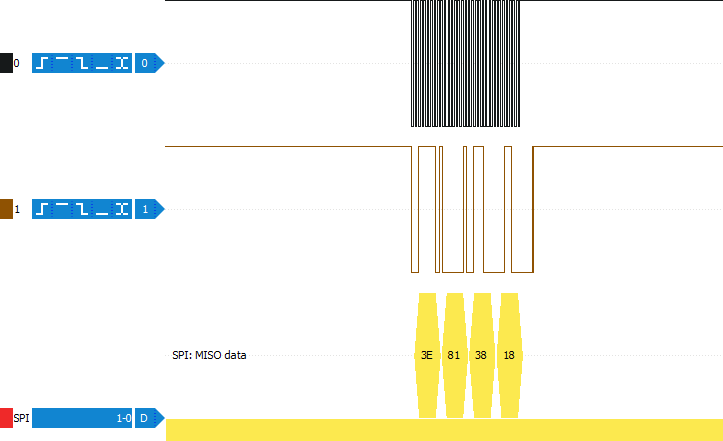

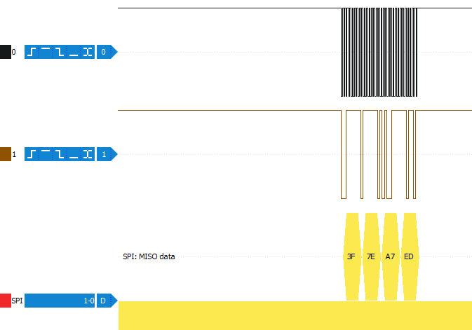

0690X00000605FoQAI.png Read Register 0690X00000605FAQAY.png The logic analyser capture below shows the address increment. 0690X00000605FFQAY.png 0690X00000605GDQAY.png Can anyone see anything wrong with the code and why the data is not sync? Paul
