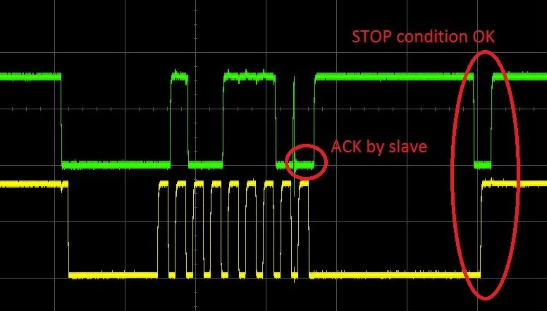

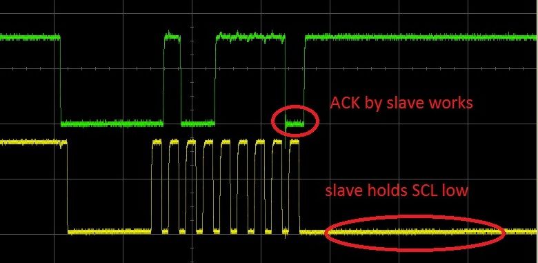

Well, I try to describe situation.
Slave is STM32F407 discovery kit, which only transmitts data (should simulate some dummy sensor). Master is some another controller board, which sends commands in two parts: 1. Master sends SLAVE_ADDR + WRITE (''0'') - serves to wake-up sensor 2. Then wait 40ms. 3. Master sends SLAVE_ADDR + READ (''1'') and expect to return 4 Bytes from slave. The first part works well, slave sends ACK, and master can apply STOP condition. 0690X00000602eyQAA.jpg But in second part, slave send ACK and after that starts to hold SCL low. 0690X00000602nnQAA.jpg My interrupt rutine:
void I2C1_EV_IRQHandler(void) {
 static
uint32_t index = 0;
uint32_t event = I2C_GetLastEvent(I2C1);
switch (event) {
case I2C_EVENT_SLAVE_RECEIVER_ADDRESS_MATCHED:
I2C_ReceiveData(I2C1);
break;
case I2C_EVENT_SLAVE_TRANSMITTER_ADDRESS_MATCHED:
I2C_SendData(I2C1, I2C_DATA[index++]);
break;
case I2C_EVENT_SLAVE_BYTE_TRANSMITTED:
break;
case I2C_EVENT_SLAVE_STOP_DETECTED:
index = 0;
I2C_Cmd(I2C1, ENABLE);
break;
default:
break;
michal239955_stm1_st
Posted on February 26, 2013 at 09:08
I forgot to mention, first reading from slave is success, slave sends 4bytes. The communication is corrupt in second reading.

looking at your scope pictures it seems that smaller pull-up resistors might help.
