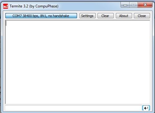

Hello! First of all let me start by telling you that i'm a trully beginner.
So, im trying to receive a string like ''hello world'' in the termite .
I already can see the bluetooth hc-05 though my phone. I can connect the bluetooth on the termite however i cant receave anything from it.
My code is the following:
#include ''stm32f4_discovery.h''

(obviously i tried to use usart_put but i cant use it correctly i think)
any help would be appreciated.

Posted on September 28, 2015 at 19:32
So you're got something like
while(1)
USART_put(USART3, ''Hello World!\r\n'');
Right?
Have you configured the HC-05 to be at 38400 baud, at it's end not the phone's end? Or is this it's default?
jota
Posted on September 28, 2015 at 19:42
yes my code was something like that but i cant put it working. the baud-rate is correct . maybe something with the connections on the stm32 to the bluetooth? i only connected the bluetooth rx - stm usart3 tx ; bluetooth tx - stm usart3 rx ; vcc and ground.
