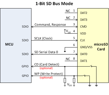

I would like to connect STM32F405VG SDIO interface. What is the best way to do it?
I implemented the following example:
Best regards.

This would be better/faster
https://community.st.com/0D50X00009XkdshSAB
