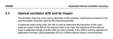

Dear @Taras_Burko ,
It is indeed a strange behavior.  can you try this
How to optimize STM32 MCUs internal RC oscillator accuracy
Try to connect via SWD/JTAG and program a simple program , then measure the HSI frequency that should be at 16MHz - you can output on MCO pin and send us the waveforms.

Dear @Taras_Burko ,
Thank you
STOne-32.
