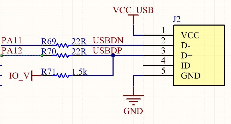

stm32f401 USB schematic
hitsumen
Posted on May 14, 2015 at 16:09
Good day,
I want to make stm32f401 act like slave for my project.
Can you tell if this schematic will work?
1 REPLY 1
qwer.asdf
Senior
Posted on May 15, 2015 at 14:07
For a working example you can look at figure 14 in this document:
http://www.st.com/st-web-ui/static/active/en/resource/technical/document/user_manual/DM00093902.pdf
