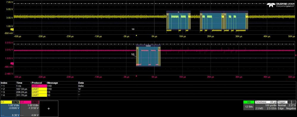

To show you what I am seeing I have attached two waveform from my scope. One shows what I am seeing when running user flash code which echos back any char sent on Rx back on Tx this is all working as expected.

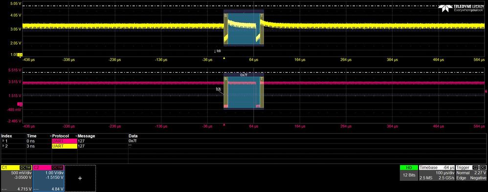

When I enter boot loader mode (Boot0=1 Boot1=0) and attempt to wake up the boot loader on USART1 this is what I am seeing.
I am getting some kind of reflection back on Tx from the chip, but no actual valid ACK response.
Do you have any further suggestions ?
If it's not responsive, perhaps it's not entering the System Loader at all, or there's an issue with the HSE clock starting, and being at a measurable / acceptable frequency?
USART2, most of the IC have this via PA2/PA3
