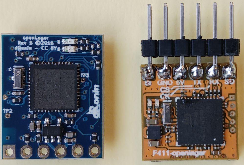

Generally you should avoid F_MKFS or any WRITE functionality until you've validated the READ functionality of the DISKIO layer of FatFS
All cards these days come formatted, and have structures properly aligned wrt the erase block size of the underlying NAND Flash array. Reformatting tends to ignore this, and is highly detrimental to performance and wear.
F4 write failures.. I'd probably make sure HW Flow Control is OFF
dRonin OpenLager
