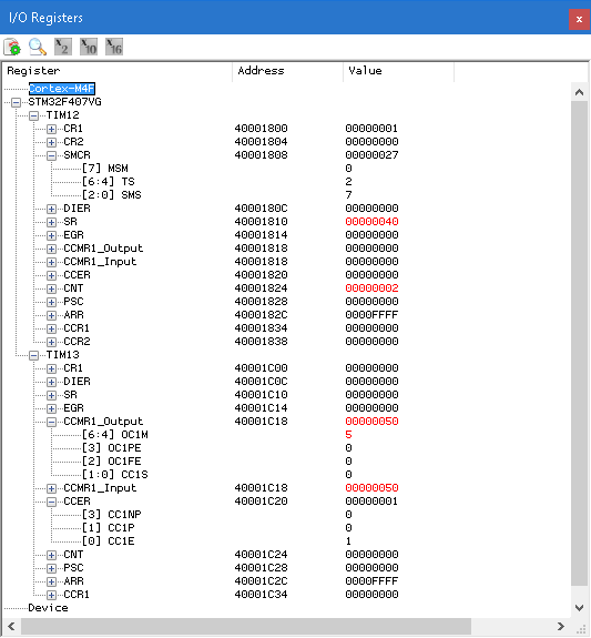

Btw., this is a great opportunity to have fun with the 'F4 in a debugger without writing a single line of code.
Run the debugger, connect to target, open the peripheral registers' view. Enable both TIM12 and TIM13 in RCC_APB1ENR. In TIM12, enable counter by setting TIM12_CR1.CEN. Write 2 into TIM12_SMCR.TS (i.e. TRGI is TIM13_OC), write 7 into TIM12_SMS (slave mode is external clock). Chect that TIM12_ARR is at max (0xFFFF). In TIM13, enable output compare output by setting TIM13_CC1E. Now write 4 and 5 consecutively into TIM13_CCMR.OC1M (these are the two force levels). Observe, that TIM12_CNT increments. Enjoy! ;) JW- Mark as New

I am also trying to do this exact thing. Using Timer 13 as a master to Timer 12. I have tried to get it working for quite some time now, 5 complete rewrites of the code but I can never get it to work properly.
My problem is that my MSB count is out of sync with LSB overflow by a random pretty large margin. (So much so that I doubt the trick to reread the values if it has flipped will work) It makes it really hard to get a 32 bit timestamp using this method. I am certain I have made an error somewhere. I tried looking at the picture with IO registers in the post above to see if something can fix it but to no avail. Unfortunately I have no ability to plug in a debugger.
