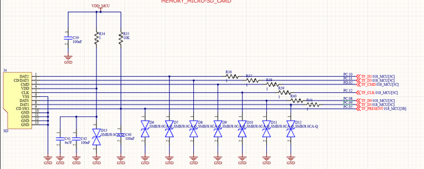

hi, I build a custom board to run EdgeTX_2.7.1 firmware on it. The board able boot up, and run but having issue to access SD card content. Further debug, SD_CLK is stuck at 400kHz.
The expected behavior of it is during initialization is 400kHz, after done it will change to 24Mhz.
Anyone can advice on it? is my schematic issues?

Related/duplicate:
SDIO CLK unable init - STMicroelectronics Community
