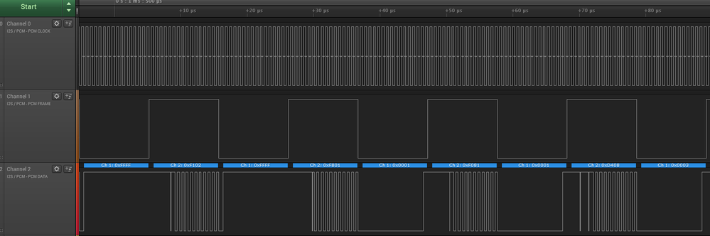

I am using stm32f4 dev kit for making that things work.

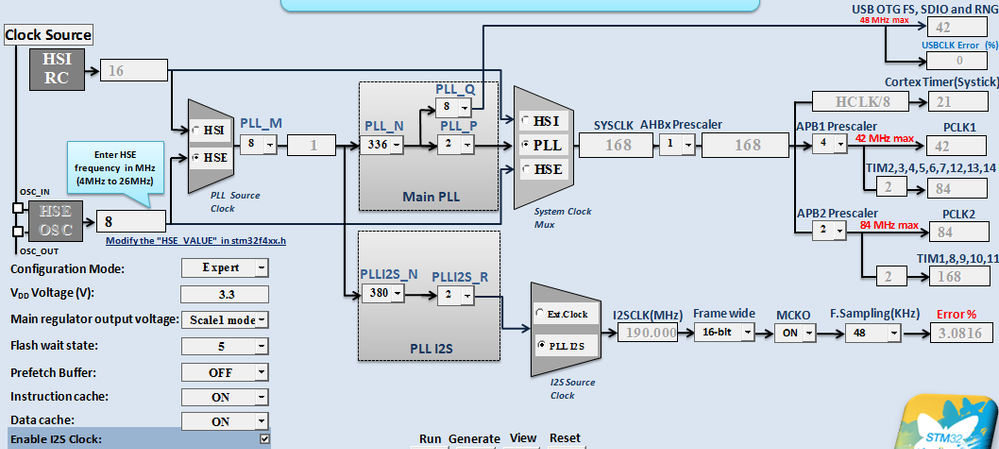

I use I2S_Mode_MasterRx for I2S module(SPI2). 0690X00000605STQAY.png For getting system_stm32f4xx.c i use STM32F4xx_Clock_Configuration_V1.1.0.xls please find my current config below 0690X00000605SdQAI.png

But i got the following diagram it seems to me the i2s does not work well any ideas? 0690X00000605QEQAY.png
Why do you think so? The master receiver should provide the bit clock and frame/wordselect/LR clock, and according to that waveform you have both of them.
The data come from the transmitter, I can't judge whether they are OK - is LR grounded i.e. mic is attempting to output on left channel? Is this waveform taken at the powerup or later?

according the picture above
- LR is grounded as a result we use ch 2
-for ch1 the data value is 0xffff or 0x0000 is it ok?
From ICS43432 datasheet:
i.e. if LR is grounded, it's the *left* microphone i.e. data is output when WS is low (ch1). What we see in ch2 is a floating (hi-Z) line, capacitively coupled to the data clock, IMHO.
Now 0x0000 and 0xFFFF is suspicious, but that's why I asked, which portion of data do we see, whether it is after the powerup or later. The ICS43432 states a rather lengthy (in terms of clocks) startup during which the data are invalid, and then a gradual fade-in (unmute).

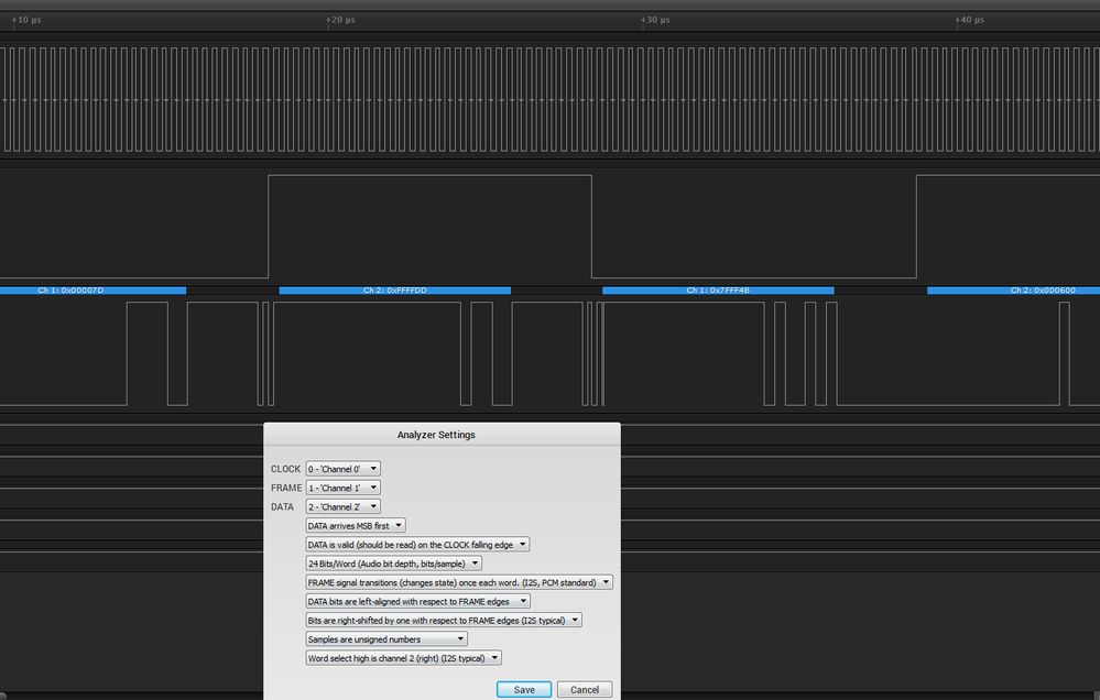

I have added right micro and redone the test
also
- I2S_InitStructure.I2S_DataFormat = I2S_DataFormat_24b;(The output data word length is 24 bits/channel)
- The data word format is 2?s complement, MSB first for ICS43432 I2S Digital Microphone
-The SD trace should have a pulldown resistor to discharge the line during the time that all microphones on the bus have tri-stated their outputs. A 100 k? resistor is sufficient for this, as shown in Figure 10. If the SD line needs to be discharged faster than a 100 k? resistor can, a smaller resistor, such as 10 k?, can be used.
but nevertheless i see this result

0690X00000605SeQAI.pngi see that there is some issue with the processing
like this one
1.157018625000000,1,0xFFFF0E
1.157039250000000,1,0x7FFF07
1.157276708333333,2,0xFFFFEF
for some reasons micro still sends data to SD pin
