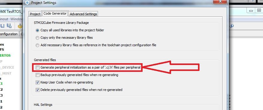

valentin
Senior
Posted on November 27, 2016 at 19:54
if you set the ''separate .c/.h'' switch in prefs, the pin config happens in the peripheral's .c file.

bram_labs
Posted on November 28, 2016 at 10:02
So, you mean these one should be left check or uncheck Sir ?
Oh, okay, thank you very much sir, i've tried it and it separates the configuration into file .c (Ex. adc.c .... main.c ..... gpio.c ....etc.)
Btw, if i just want to add the ADC port, i just need to change the configuration in adc.c right ? Oh yeah, and btw, does it need to be reconfigured in 'main.c' after i applied some change in 'adc.c' ?
