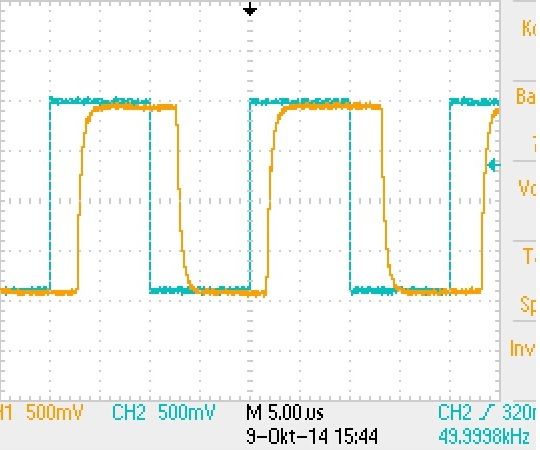

Unfortunately the software triggering didn't solve my timing problem. As you can see in the attached file (green = input signal, yellow = dac signal), the rising edges of the yellow signal doesn't appear at the same moments...- Mark as New
‎2014-10-09 7:28 AM
The DAC has a settling time of about 4 microseconds (also depending on step size - look it up in the datasheet). I'm not sure what you want to achieve with re-sampling the DAC output (if I got that right). But in general, DACs are not the best solution to generate binary signals.
‎2014-10-10 3:20 AM
It's not about the settling time, it's the unpredictable time variance when the next rising edge of my dac output signal occurs. Sometimes the latency between the rising edge of my input signal and my DAC output signal is 3us, sometimes it's less, sometimes more...and I want to control this behavior....
Maybe I should explain my project. I want to sample signals, generated with a function generator, where fmax is 50 kHz, process the signal (fir, iir filters ... ) and put it back out with the dac. Usually the signal will be a sin-wave, but at first I wanted to try it with a square wave signal (as my ''worst case''). When my input signal is below 10 kHz the time variance of my output signal is no problem, it's still there but the period of my signal is much bigger than the error. Is it possible to put a timer-interrupt in my dma-interrupt routine?- Mark as New
‎2014-10-10 5:14 AM
At first glance I would assume a problem with interrupt priorities here - but I can see only one interrupt in the provided source. Did you try to measure the interrupt frequency and runtime jitter without DAC ? I would toggle a GPIO pin to visualize this. Some comments to your ADC code: First, for just one sample of one channel, you don't need DMA. You can use the ADC EOC interrupt instead. Second, a sampling time of 3 cycles is rather short. This requires good signal conditioning circuitry (fast, low impedance). Otherwise, you get signal distortions.Maybe I should explain my project. I want to sample signals, generated with a function generator, where fmax is 50 kHz, process the signal (fir, iir filters ... ) and put it back out with the dac. Usually the signal will be a sin-wave, but at first I wanted to try it with a square wave signal (as my ''worst case''). IMHO this requires the DAC to be triggered via Timer. The filter calculation would introduce an incalculable jitter. You only need to guarantee the cycle time. In theory, this should be possible with one timer, since e.g. TIM2 is listed as possible trigger for both units. I have never tried this, however.
