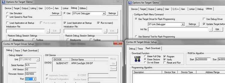

Hello everyone. I've buy a new STM32F3DISCOVERY kit but I'm not debugging it with keil. When I want to start debug session it is failuring, ''Error: Flash download failure - ''Cortex-M4'''' with this error. My debug and utilities setting is 0690X00000603GLQAY.jpg

In the ''Flash Download'' window you do not have a ''Programming Algorithm'' selected. You need to ADD the ''STM32F3xx Flash''
