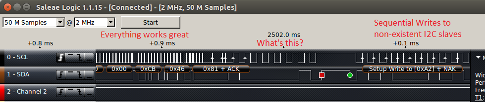

I'm using I2CSTM32F207ZET6. It usually works well, and we can usually read and write with no problems. However, there is a consistent error that pops up where, if we are reading a number of bytes sequentially, the reads will fail. After that, it looks like the STM32 goes through several I2C addresses polling for an available slave (I'm not sure why this is happening now). We've captured this on a logic analyzer. This behavior happens every time the error occurs. 0690X00000605HQQAY.png This picture shows the I2C bus correctly reading sequential data from an EEPROM. At some point, the STM32 acks a received byte and then the clock duty cycle changes for a bit. After that, it looks like the STM32 tries to cycle through various slave addresses (starting from the address of my EEPROM+2). Here's how I'm setting up the I2C bus:
