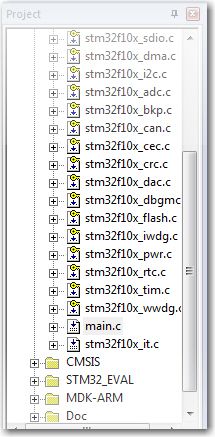

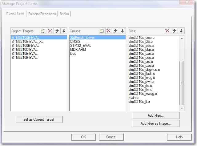

I made :
STM32F10x_StdPeriph_Lib_V3.5.0\Project\STM32F10x_StdPeriph_SPI DMA V1
and
pull all the files from
STM32F10x_StdPeriph_Lib_V3.5.0\Project\STM32F10x_StdPeriph_Examples\SPI\DMA
into :
STM32F10x_StdPeriph_Lib_V3.5.0\Project\STM32F10x_StdPeriph_SPI DMA V1\DMA
Do you mean, I must make :
STM32F10x_StdPeriph_Lib_V3.5.0\Project\STM32F10x_StdPeriph_SPI DMA V1\SPI\DMA
I have compiled that project and it works, but is it correct already ?
main.c from
is inside
Is the compiler using ''main.c'' from it ?
Thanks

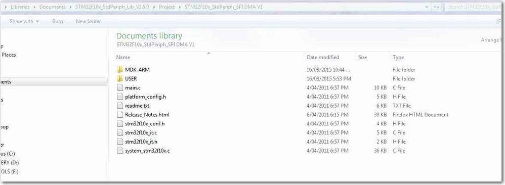

Posted on August 16, 2015 at 22:39
The files from
STM32F10x_StdPeriph_Lib_V3.5.0\Project\STM32F10x_StdPeriph_Template
AND
Go into
NOT
or
You need to maintain the same tree depth as the template, is this really that complicated? ie ONE level off the Project directory

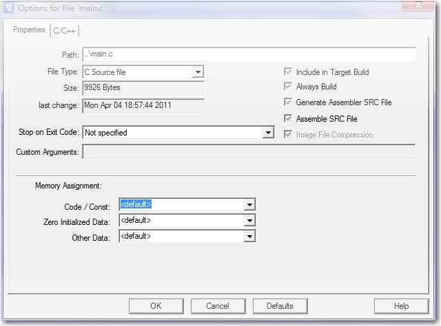

Right Click on the file and LOOK at the properties about where the file is coming from.  Edit the file and puts something in your recognize, and then view it with your preferred file manager of the directories and files.

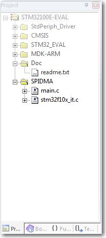

So it will be like this :
Posted on August 17, 2015 at 15:19
Looks reasonable. Right click propertiesof the file (options for file) in the project should confirm it's location

''.\STM32100E-EVAL\STM32100E-EVAL.axf'' - 0 Error(s), 0 Warning(s).  0690X00000602ZMQAY.jpg   Do you mean this option ?
Posted on August 17, 2015 at 15:51
Yes, so one level above the MDK-ARM directory the project file is in..
