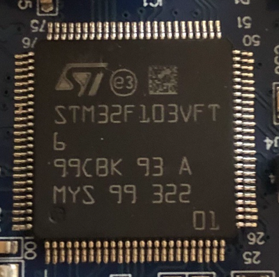

If I check the completely name writted in the microcontroller I can see: STM32F103VFT6 99CBK 93 A MYS 99 322
Is this batch the problem?

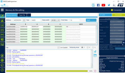

The UniqueID is:
The top marking of the pill is:
The top marking of the package I don't have know here because I sent to my PCB manufacturer. I bought these microcontrollers in Official ST Distributor.
