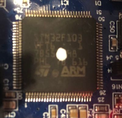

Can you provide a picture of top marking ? Also using ST-link utility to have the UniqueID in that device .
how many parts are impacted ? And finally what means You can not debug ? If possible to provide more details with MDK Keil ?  Most probably it is not a genuine ST product and please check with you PCB manufacturer on their sources .

The picture of uC is:
Image (2).jfif

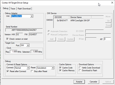

I do the follow steps:

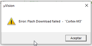

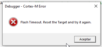

1) Open the keil and compile. Press "Start Debug Session"
2) The following messages appear:

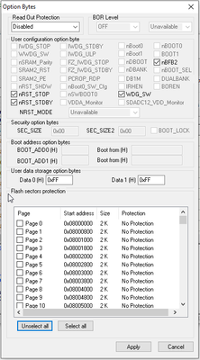

3) then I open St-link Utillity, and connect the target. The go to Target menu > Option bytes, I DON'T change anything, only "apply" the current options:

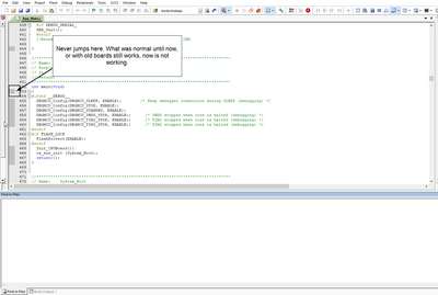

4) Then go to Keil again, and press "Start Debug" and it
5) But the cursor do not is in "main" function.
6) If I burn this part of the project with the St-link utility, there is no problem and the code progresses and the device works fine. So, I can't debug.

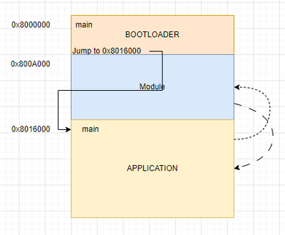

My project has three parts: Bootloader, a Module, and application part.  From bootloader the code jumps to application part, and it when is working the device does some queries to Module part and it answers.

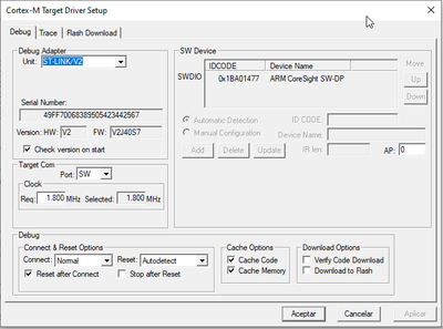

About Keil + St-link:
What do you think can be happening?

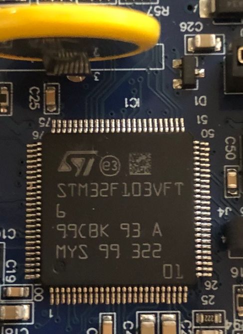

When I do the same with old board:
There is no problem, I can debug:
Hi @FLast.14 ,
The marking of the device shows it is not an ST genuine Part as we never split the STM32F103VFT and then 6 on new line .
as shown in the working MCU .
please contact your manufacturer/supplier

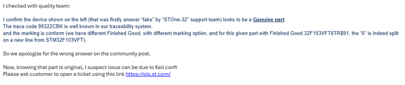

I've contacted with my components supplier, this is an official distributor from ST in Spain, and they say:
@STOne-32 do you have any other answer?

Hi @FLast.14 ,
Yes, now the right path is to Open an official Ticket on our Online support, you will be in touch first with our regional team : Technical and Quality for follow-up of this unusual strange case indeed .
Cheers,
STOne-32.
