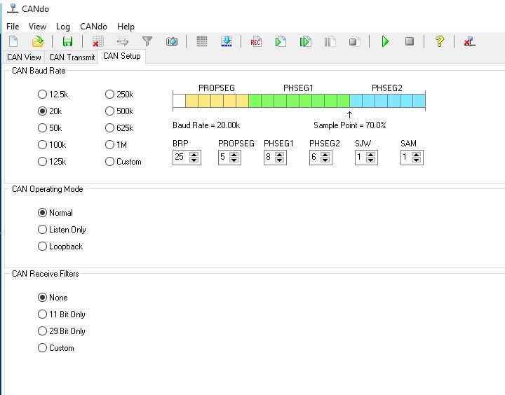

Posted on April 26, 2018 at 01:29
I used the CanDo unit for a week. everything worked brilliantly with the code I have already given you.
here are the sample points required by CanBus

Posted on April 26, 2018 at 09:43
Okay so ...
For some reason, it seems that the different Time Quantas my Peak USB likes to receive are different than what
GONZALEZ.Laurent
mentionned. I managed to find this out while searching a bit in the submenu of PcanView.
So now it seems to be working ...
I feel a bit dumb though, but thank you everyone for the help anyway !
