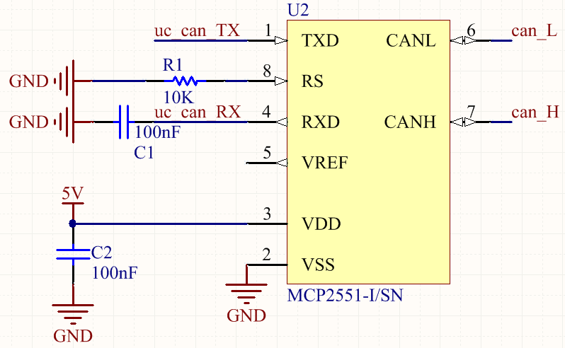

Hello guys!
I am new in using CAN interface, and for the first time, I started to use it in my project. I used STM32F103C8t. When I wanted to use CAN interface, there only happens time-out exception in run-time and I figured it out both in run-mode and then in debug mode. I wrote a very small project to work on it and I got the same problem. I doubted if the mcu is not working well, I changed it and still not change, I even changed the mcu with stm32f103cBt one and no change either.
I give you the simple code I created using HAL library and STM32Cube here and I hope you can help me
this is the code:
In this code if CAN works, the relay must toggle almost in 10HZ frequency, and if time-out happens the relay must toggle in 1Hz frequency. In practice, the relay toggles in 1Hz!!!

If you don't have a transceiver chip, then you must pull up the CanRx pin, or the processor will hang at startup.
if you can single step, can you see the chip working upto a point ?

abbas
Posted on March 16, 2018 at 10:37
I forgot to say that, I used MCP2551 as CAN transceiver and I mounted this IC on the board like this(forget 100nF in RX, I hadn't assign true value for it at that time):0690X0000060A92QAE.png
and besides, I tested my code at loop-back mode in which, apparently, there is no need for external electrical connections, but I didn't get any result
About your question, I changed the code to this
  while (1)  {
        sprintf( (char *) hcan.pTxMsg->Data, ''%s'', msg );
        hcan.pTxMsg->DLC = strlen(msg);
        HAL_CAN_Transmit(&hcan,10);
and I didn't see any activity at mcu CAN output. After it, I unmounted the MCP2551 chip and put a 10K pull-up resistor and I checked it again and still no output!
Posted on March 16, 2018 at 10:40
No clive, but as I responded to T.J., I even tested the CAN in loop-back mode and I didn't get any result
