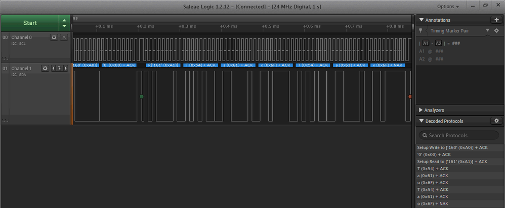

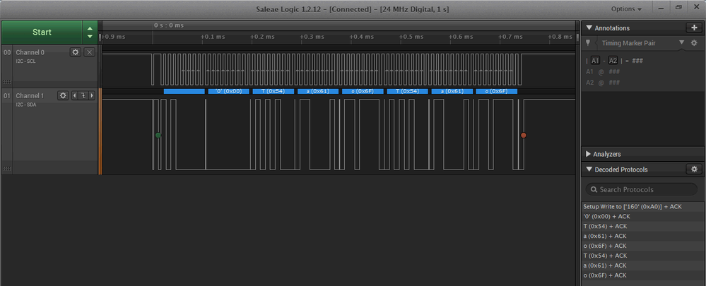

Now, i can solve i2c,
Lib from HAL..
HAL_I2C_Mem_Read() :
Algorythm of HAL_Lib is not mathing with EEPROM, so it can not use
i coding easy functions for solve this problem and oscillope by Saleae Logic Analyzer,
i follow timing diagram of RM0008 of STM and data sheet of EEPROM
Now it work..
but HAL_I2C_Mem_Write() : it is correct, it can use
thank you every body :)
