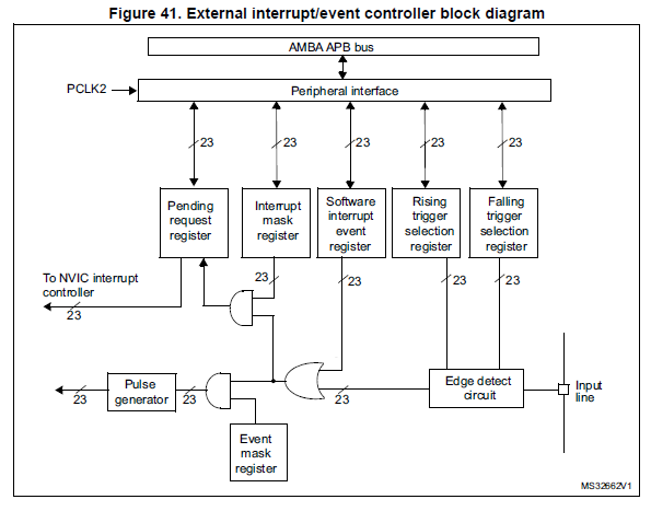

I can not find enough information about the definition of a software interrupt with NVIC.
If the edge of an internal software bit is positive, an interrupt routine should be executed

You haven't mentioned what processor you are using. If you are looking to set up an interrupt that may be triggered by software, consult your reference manual and do a search for 'software interrupt'. In the STM32F407, the EXTI controller has a register called 'Software interrupt event register'. From the reference manual: 'An interrupt/event request can also be generated by software by writing a ‘1’ in the software interrupt/event register.'
Posted on March 05, 2017 at 10:28
With setting:  EXTI_IMR |=0x10; and  EXTI_EMR |=0x10;
when i write: EXTI_SWIER |=0x10; then  EXTI_PR changes from 0x00  to 0x10 (Ok)
Question: which interrupt subroutine is executed EXTI_IRQ4_ISR() ?

Posted on March 05, 2017 at 12:26
The SW interrupt replaces the Input pin.
Available interrupt vectors are:
DCD EXTI0_IRQHandler ; EXTI Line0
DCD EXTI1_IRQHandler ; EXTI Line1
DCD EXTI2_IRQHandler ; EXTI Line2
DCD EXTI3_IRQHandler ; EXTI Line3
DCD EXTI4_IRQHandler ; EXTI Line4
DCD     EXTI9_5_IRQHandler                ; External Line[9:5]s
DCD     EXTI15_10_IRQHandler              ; External Line[15:10]
(startup_stm32xxx.s file)
Usually the interrupt handlers are in stm32xx_it.c

Posted on March 05, 2017 at 22:08
P388 from RM
Take an example in cube of EXTI external interrupt with GPIO. Put a breakpoint in the interrupt routine.
Trigger the interrupt and confirm code stops. Now, open the EXTI HW register window in the debugger and manually disable rise and fall detection on that EXTI. continue the code until it goes back to main loop. Stop the code and set the corresponding SW interrupt bit. Continue the code and check if the interrupt breakpoint is activated. If successful, then the rest should be pure coding...
