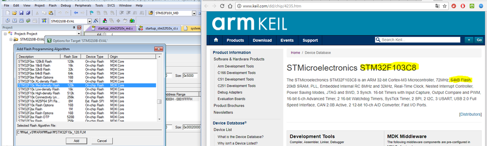

Hi
I'm curious which one is correct item.
I would like to select the correct memory model to STM32F103C8
But I can't see anywhere
Could you help me what am I supposed to do in this case?

Hi.
You made the correct choice.
Your device is medium density and you choosed the medium density F10x device.
