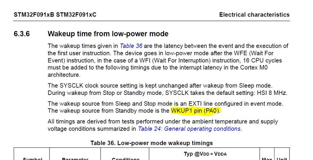

Hi
Code seems ok.
I found an interesting point in Datasheet. Shouldn't be written.
Try to Wake Up the MCU with PA0 pin, if works need further investigation..
BKath
Hi Vangelis Fortounas
Thanks for your response.
Also checked keeping PA0 pin as wake-up source but still MCU does not wake up.
Any other suggestions please?
