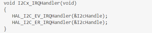

hi, if you just want callbacks after HAL_I2C_Master_Transmit_DMA and HAL_I2C_Master_Receive_DMA routines,
You just need to implement your
void HAL_I2C_MasterTxCpltCallback(I2C_HandleTypeDef *hi2c);
void HAL_I2C_MasterRxCpltCallback(I2C_HandleTypeDef *hi2c);
they are weakly defined in stm32f0xx_hal_i2c.c,
Don't forget to enable I2Cx event global interrupt. So that in your stm32f0xx_it.c,
you will see something like
void I2Cx_IRQHandler(void)
HAL_I2C_EV_IRQHandler(&I2cHandle);
HAL_I2C_ER_IRQHandler(&I2cHandle);
Good Luck!

‎2017-07-07 9:06 AM
Hi Zhitai Liu,
Thanks for your support Now I get interrupt callback to my upper layer.
Using:
