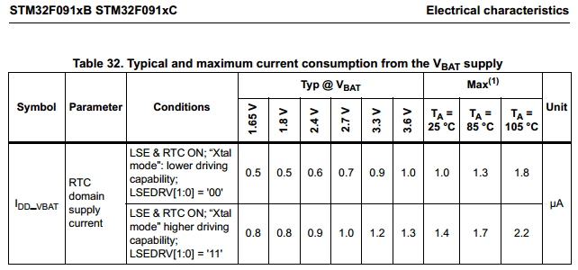

By the way, check the following values from datasheet
1 To exclude custom board hardware issue, I would first use a nucelo board, disconnect VBat and VCC, and perform the current measurement.

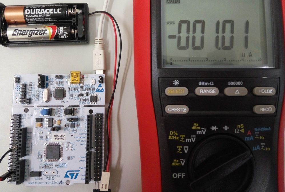

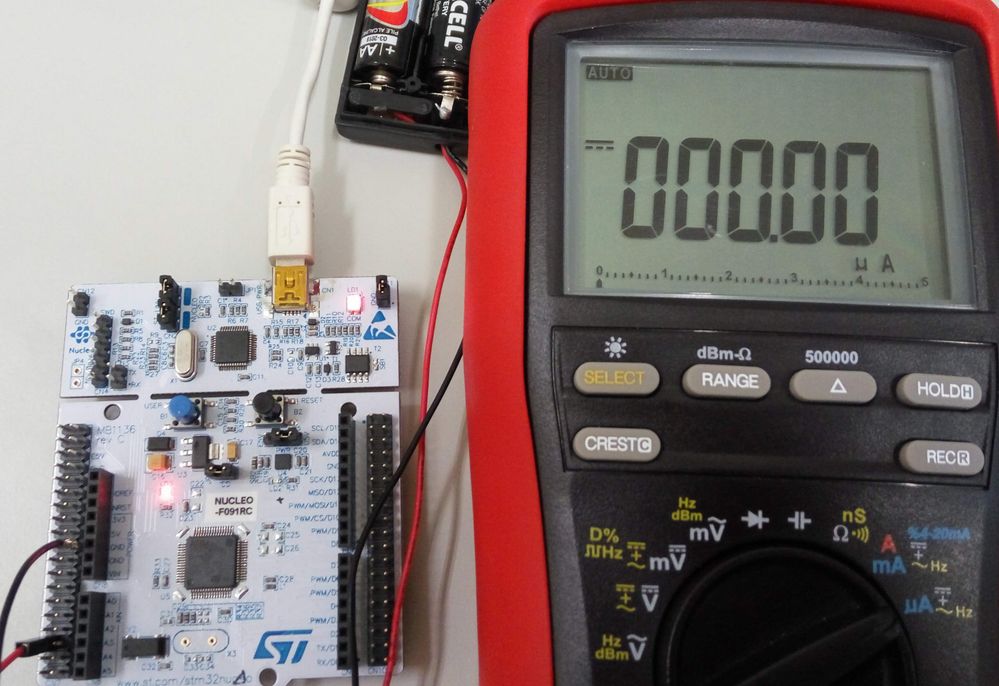

Using two AA batteries Vbat around 2.6V.
with VCC On.
VBat to Gnd impedance, there are few Mega Ohms.
