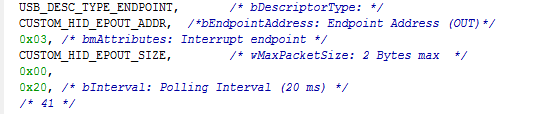

That all works fine. Then I wanted to do a speed test to see whether the STM can use the USB FS speed fully (which should be able to send a 64B packet every ms). So I removed the HAL_Delay(500); call.
The result: only 32 packets are now sent per second. I confirmed this with my own application based on hidapi, and also with hidapi's general-purpose ''test receiver''.
Is it normal that the rate of HID transfer is this limited? Should I be able to reach 1000 packets/second? If so, does anyone have a clue what may be limiting the rate in this case?

    I found the answer to my issue. It turns out there is a setting for the ''Polling interval''. By default it is set to 32ms. It is found in usbd_customhid.c:

    The ''bInterval'' field can be changed to 0x01, after which I saw 1000 packets per second as expected. That still leaves the question for me: is it normal to change this setting? It seems a bit strange to have to change the driver code instead of just the values configured in user code. Thanks!

    It seems that Denis answered vock's question. And for the comment for the bInterval, it has been changed on the latest releases :

    But still 0x20 is 32 ms, not 20

    I see the issue you highlight. It will be solved soon, I will keep you inform as soon as CubeMX contains this modification.
