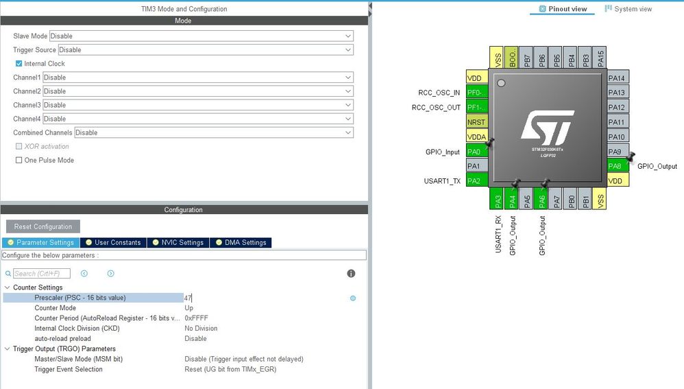

Hi every body, how can I create a microsecond delay in STM32f0? ( this MCU has not DWT register)
Thank you

Use any other free-running TIM to delta progress of time.
Clock a 1 MHz or faster to improve resolution. Don't interrupt. Remember most TIM here will be limited to 16-bit.​

Set the TIM up in Timebase mode, set the Period as maximal, ie 0xFFFF
Set the Prescaler as MHz-1, ie 31 if the bus clocks at 32 MHz, the tick time should be 1us
void delay_us(uint16_t us)
 uint16_t start = TIM2->CNT;
 while((TIM2->CNT - start) < us); // rebase, then compare
Thank You, Please check my CubeMx config, is it correct?
my HCLK = 48Mhz
Looks reasonable, not using CubeMX here. Likely some timebase examples under the HAL CubeF0 trees also
