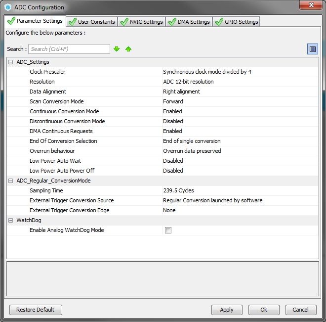

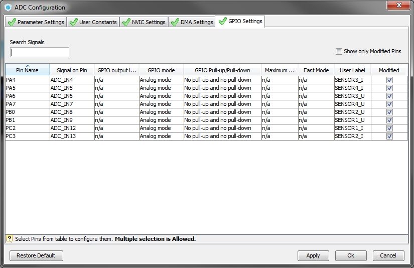

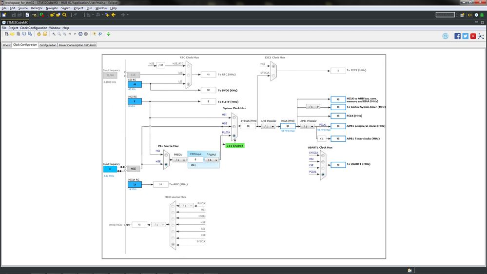

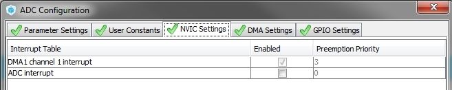

Hi, I have a strange problem with ADC values reading. My MCU and ADC is configured like below:
0690X000006046HQAQ.jpg0690X000006046RQAQ.jpg0690X000006046XQAQ.jpg0690X000006046WQAQ.jpg0690X000006046bQAA.jpg
My main.c is like below:

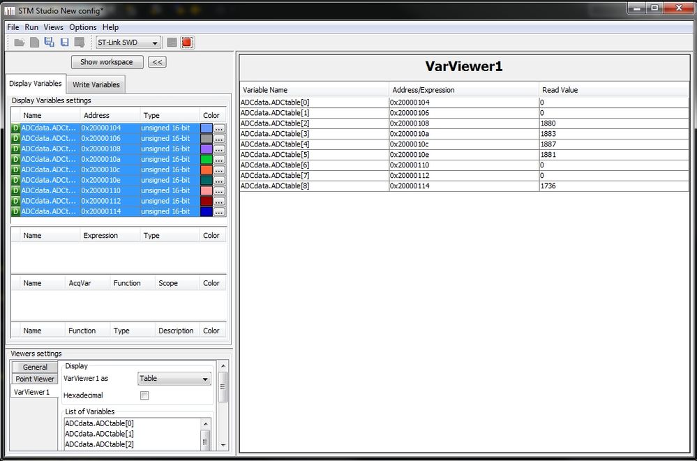

While reading ADCdata.ADCtable  I am getting something like that on UART: ... 00 00 00 00  07 01 07 01  07 01 07 01  00 00 00 00 06 01 ...
it's mean:
ADCdata.ADCtable[0] = 0x0000 -> 0
ADCdata.ADCtable[1] = 0x0000 -> 0
ADCdata.ADCtable[2] = 0x0701 -> 1793
ADCdata.ADCtable[3] = 0x0701 -> 1793
ADCdata.ADCtable[4] = 0x0701 -> 1793
ADCdata.ADCtable[5] = 0x0701 -> 1793
ADCdata.ADCtable[6] = 0x0000 -> 0
ADCdata.ADCtable[7] = 0x0000 -> 0
ADCdata.ADCtable[8] = 0x0601 -> 1537
and in the same time (while HAL_Delay(1000); <- from send_my_data) I did printscr from VarViewer1:
And my question is:
What I am doing wrong ? How to read correct this data ?
Please help,
