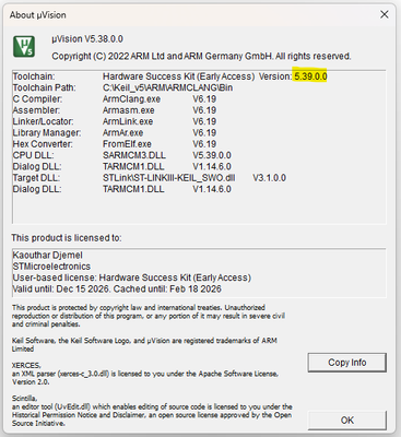

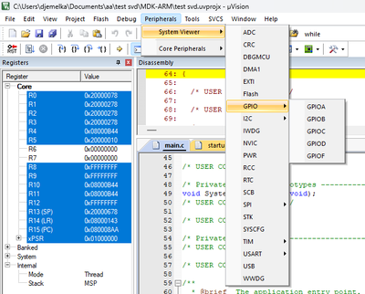

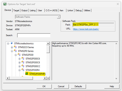

Hello @Kent;
I tested the issue with MDK KEIL version 5.38 and STMF0xx_DFP 3.1.1 version and I can see the peripherals registers as shown in the below figures:
I think the issue is related to KEIL version or KEIL installation.
Could you please try to reinstall the toolchain.
Thank you.

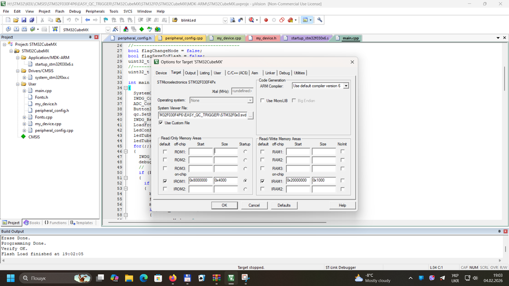

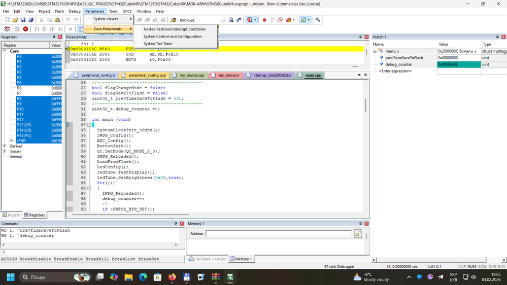

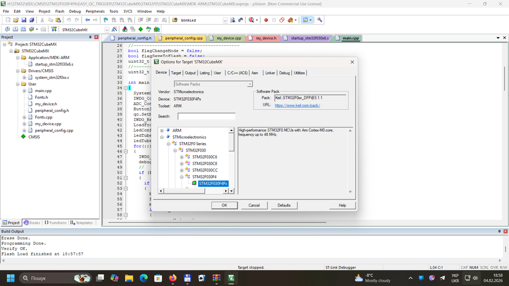

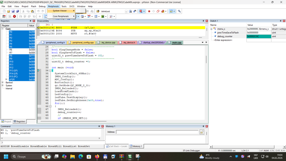

Hello!
Problem not solved. Peripheral registers (GPIO, RCC, etc.) do not appear for the STM32F030F4P6 series.
2026-02-04 1.png2026-02-04 2.png2026-02-04 3.png2026-02-04 4.pngMDK Keil 5.38a + STM32F0xx_DFP.2.1.1 all working.
Kent
Why STM32F0xx_DFP.3.1.1 has size 567kB, STM32F0xx_DFP.2.1.1 but has size 66.07mB. Maybe there is a problem in this?
