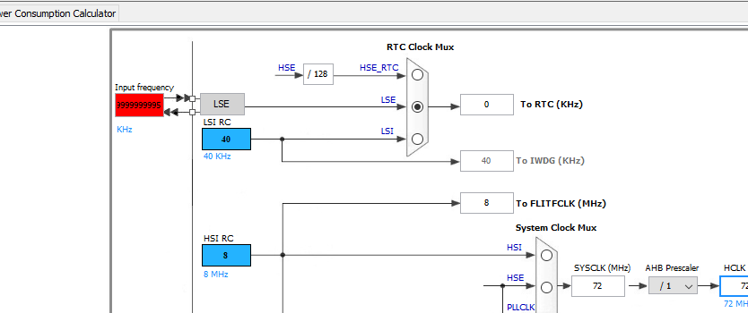

Hi There!

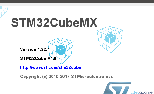

Hi have already post this issue but nothing changed from those time. May be i have ''unique'' version of qubeMX but this annoying bug chase me.
When I change the Input frequemcy value I get this bug. Please look at the picture below. I can't return bach normal values - all of them in a float point state.
It works for PC vercion and plugin of current wersion.
Have somebody the same issue?

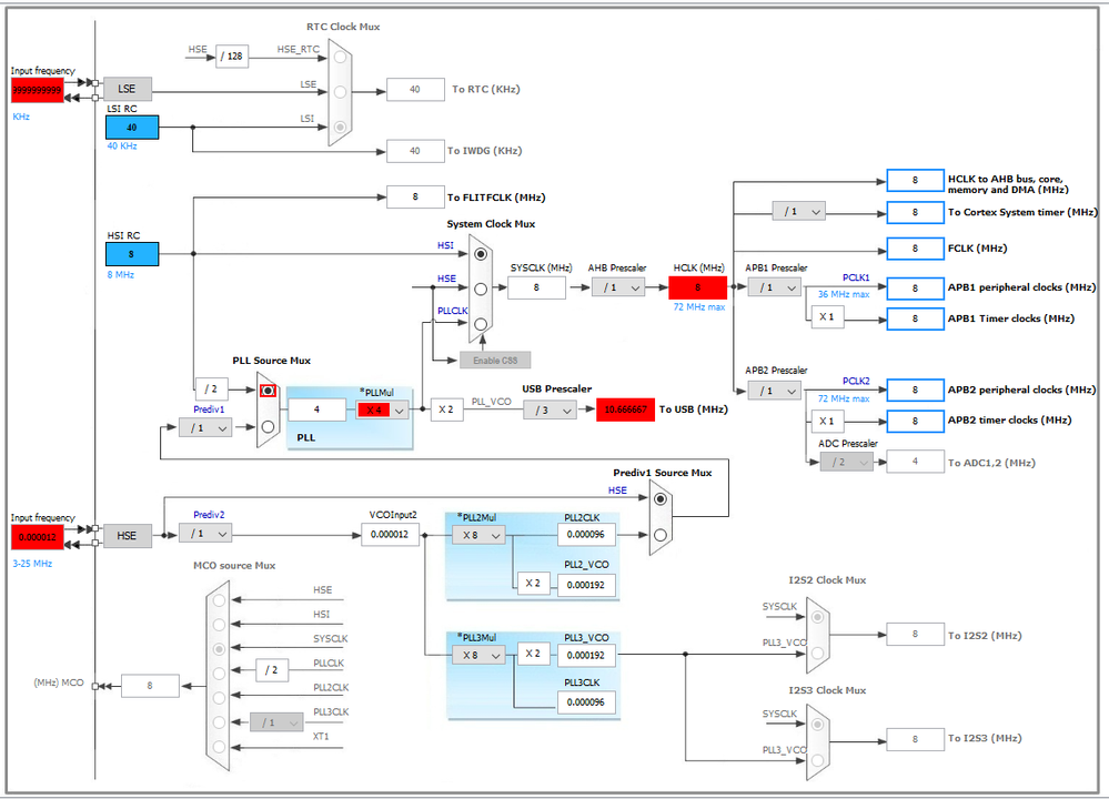

Hi again!
I've done fix.
I manulally changed next strings in the *.ioc file :
RCC.LSE_VALUE=32768000000
RCC.RTCFreq_Value=32768000000
RCC.HSE_VALUE=12000000
and now it looks like it works
before there were somthing like this: RCC.HSE_VALUE=0.0000000000000000012000000

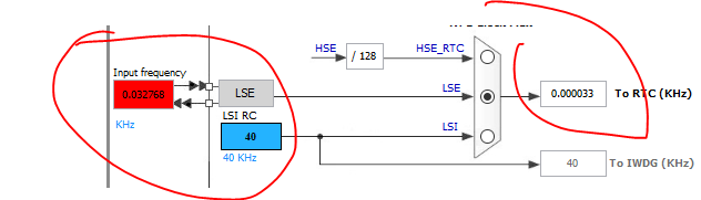

I see that ir recalculate by circul! I am switching beetwin tabs:

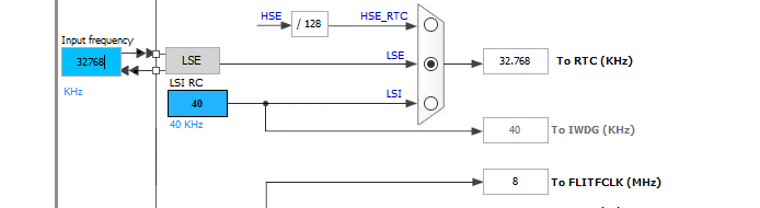

I typed to input frequency field : 32768000 and clicked to the side:
it was devided by 1000))
i opened next tab and open the clock tab again:
and again:
I hope it'll help.
