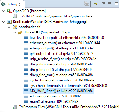

I start a project with STM32CubeMX and a NUCLEO-F207ZG board. My goal is to have a TFTP client, but for now I'm stuck getting an IP address with DHCP. You can find my project attached.
In the lwip.c, I had to modify the MX_LWIP_Init.c file of the generated code (not in the user section), otherwise the code stops in
LWIP_ERROR('netif is not up, old style port?', netif_is_up(netif), return ERR_ARG;);
What is wrong with the STM cube configuration ?
Plus, I never go to the ethernet interrupt. How the ethernet reception is handled when there is no operating system ? (NO_SYS configuration)

Also, I noticed the function low_level_output in ethernetif.c return an error. I go into this ''if'' function after 4 retries from DHCP stack :
/* Is this buffer available? If not, goto error */
      if((DmaTxDesc->Status & ETH_DMATXDESC_OWN) != (uint32_t)RESET)
        errval = ERR_USE;
        goto error;
But the error is not shown as udp_sendto_if_src doesn't take the returned status into account.

I finnally found the problem by comparing the STMcube project example on STM32F207ZG_NUCLEO_144. The STM cubeMX doesn't generate the proper code for the Nucleo board. First, the physical address need to be 0 instead of 1, and it only work in RMII mode.
