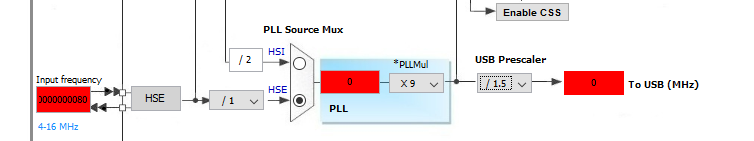

Hi all!
The Clock Configuration GUI shows a weird behavior: I'm not able to put a valid input frequency for HSE (or LSE).
For example I want to setup the input frequency to 8 MHz:

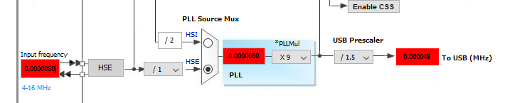

- entered value 8 is not accepted - changed to 0.0000000000080 immediately
- entered value 8000000 is accepted and changed to value 8 but as soon as the focus is changed to an other element the value jumps to 0.0000080

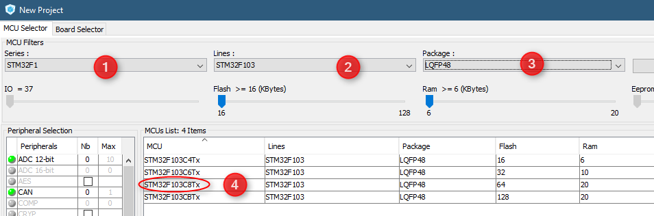

create new project

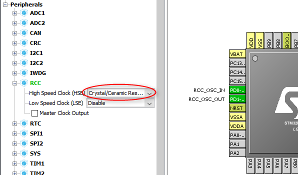

enable High Speed Clock

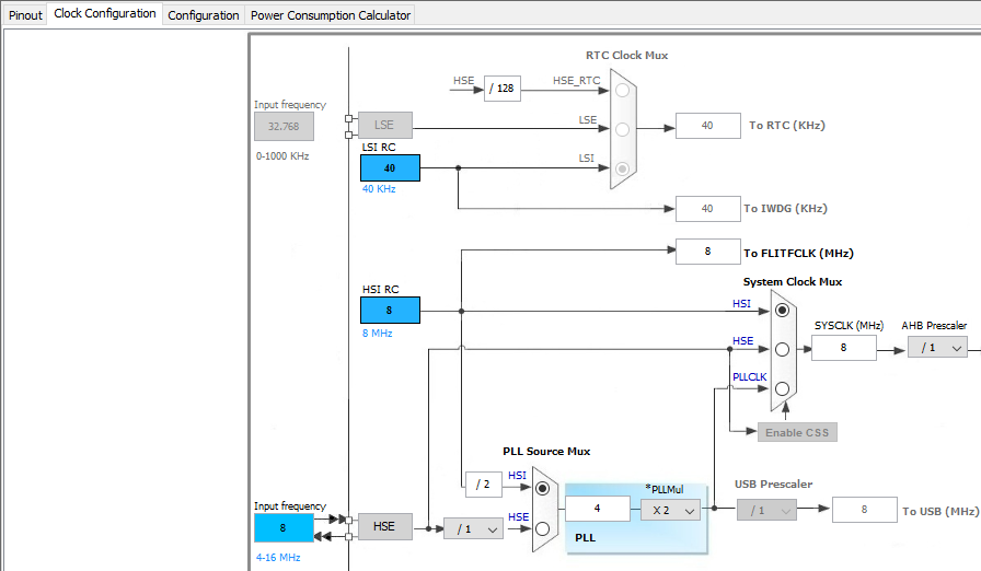

Default clock setting shown good as expected

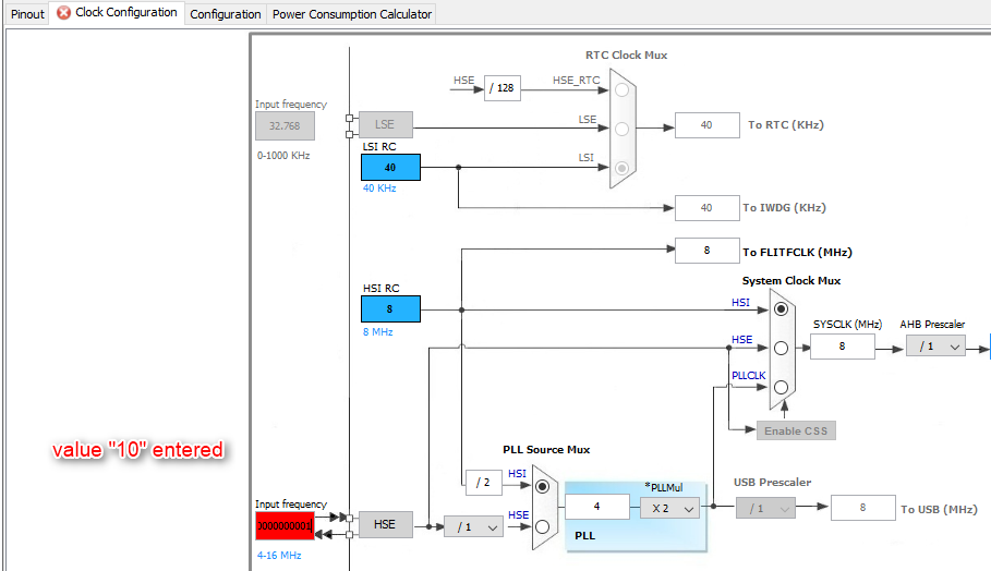

but as soon I change the default value the GUI shows wrong values
clock values entered in Hz (e.g. 10000000) are temporarily accepted as 10 MHz but as soon as I change the focus (activate another element) the entered value becomes invalid.

Hello, had the same issue but found a workaround:
the gui erroneously validates the frequency input dividing it by 100000 and rewriting the divided value to the textbox: this is the bug.
So,
you don't have to press enter
once the crystal frequency is entered (in Hz) into the textbox, butsimply move the focus to another component on the page (a prescaler combo, a radio button, whatever else).
